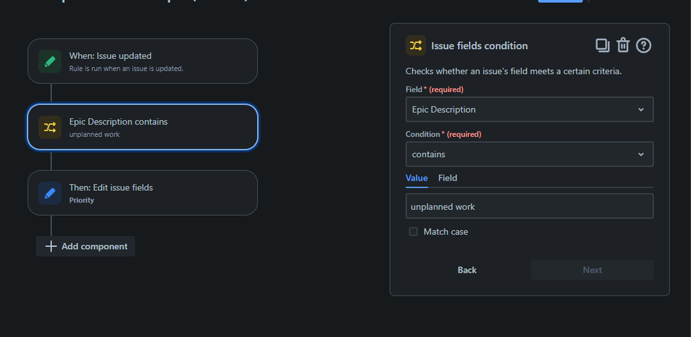

I'm trying to create a rule where on create or edit (maybe two rules), if the issue was added to an epic whose name contains 'unplanned work', the issue's priority should be updated to 'highest'.
I can see in the audit log that the triggers are firing but no rules are being applied due to no match. I've tried a couple field conditions with no success:
  • Epic name contains 'unplanned work'
  • Epic description contains 'unplanned work'
  • Epic/Theme -- didn't get anywhere with this because it makes me pick values from a dropdown, and I don't know where those values are coming from.

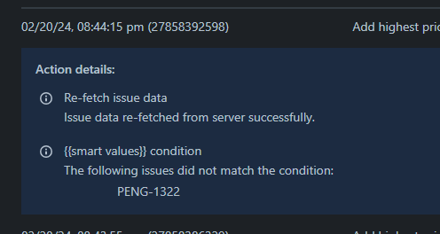

Dang that didn't work either. I re-fetched but the smart value still didn't match. Is there a way to see what the smart values9nzjoC1XGm.pngOpGZJrV8kz.png component is getting?

actually I was able to log {{ issue.parent.summary }} and it has the right value, it's just not matching. Missed your other point that this component is actually case sensitive.
It's working now! If only i could make it case insensitive. Thanks for the help!
update: turns out the re-fetch isn't necessary
