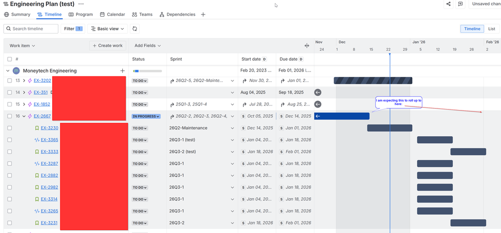

As per screenshot.
I have child items allocated to future sprints. I expect the epic to reflect that in its rolled up date, but it doesn't:
It appears to work as expected when looking at the timeline on the board itself.
Also, any idea why I can't select and change sprints in the timeline view (drag and drop) from Plans, like I can from the board timeline? This feels like a backward step to me.

Hi @Navil Narayan
You are correct, this is also visible in the plan, as the dates in the Epic are set and not based on roll-up.
Epic should never be added to a sprint.
Here is a kb with options to remove historical sprint values from a work item; how-to-remove-previously-closed-sprints-from-an-issue

So i think I worked it out. Looks like the epic was assigned to a sprint, that is now completed.
I can't figure out how to remove the historical (closed) sprint that it was assigned to in the past. I think that might be preventing the roll up of the child items sprint dates.
Navil Narayan
December 23, 2025
Went for option 2 at link: https://support.atlassian.com/jira/kb/how-to-remove-previously-closed-sprints-from-an-issue/
and used bulk update to remove the historical (closed) sprints that were assigned to the epic. This has fixed the rollup issue on the epic
