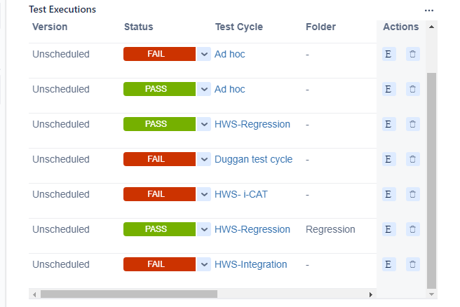

I didn't get that addon installed as of now as admin asked me to first confirm on these points .
Here is the Zephyr test execution status image I am talking about ,will these be accessible from AUtomation rule any idea ?
I want JIRA status to be updated with latest Zephyr Execution Status .
Can I apply rules on these status and main JIRA status .
Thanks  MUch!
Neha
Bill Sheboy
December 11, 2020
Hi Neha,
The automation for Jira in Cloud is built-in, so you should be able to check if the test execution information is available without any additional add-ons.
If you cannot easily identify the names of the smart values (fields) for the data, you can make a test call to the REST API with a user story that has Zephyr fields, and that will reveal the names.  Here is how to do that:
https://support.atlassian.com/jira-software-cloud/docs/find-the-smart-value-for-a-field/
If it is still unclear if Zephyr can work with automation for Jira, I suggest sending a question directly to Zephyr support:
https://marketplace.atlassian.com/apps/1014681/zephyr-for-jira-test-management?hosting=cloud&tab=support
Best regards,
