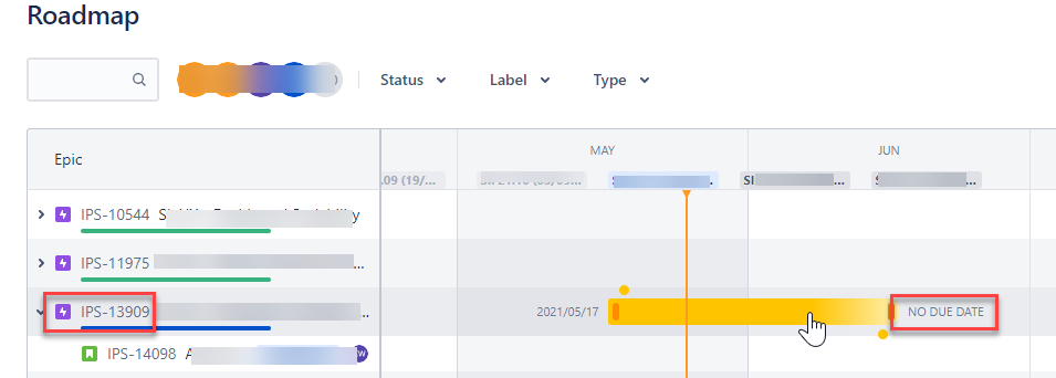

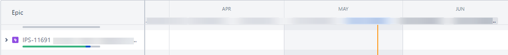

Hi Danielle
I had a look again with the following observation
In Advances roadmaps, there are no Changes to be reviewed
When I compare AR with the simple roadmap I can see that there are differences in the start and end date if the dates were not set manually. In another words, if dates are rolles up in AR, it doesn't carry it over to Roadmaps.
Please see examples below:
Example of Rolled-up dates in AR that is not synced back to Roadmaps
Example 1
AR
Roadmaps
Example 2
AR
Roadmaps
Example of manual set dates in AR that do show in Roadmaps
Example 1
AR
Roadmaps
