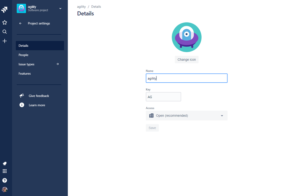

Alexey Matveev
October 23, 2018
You can find out if your project is a next-gen project from the project detail view. There is not the Project Type field there:
It is not possible to change a classic project to a next-gen project. You should create a new next-gen project and move all issues from the classic project to the new one.
Roadmap only works for a single next-gen project. It can not select issues from other projects.
