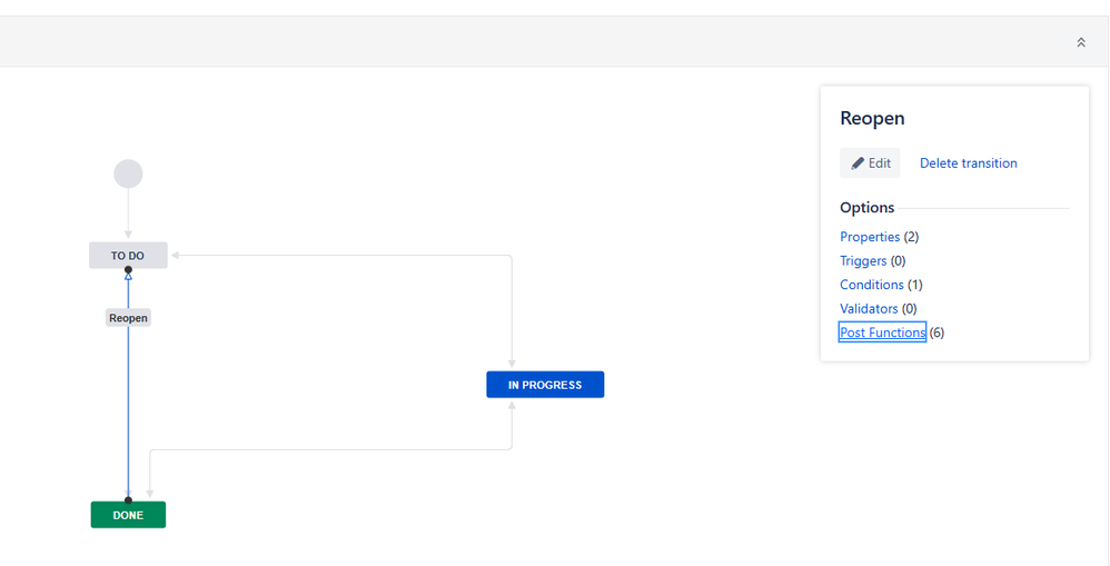

If we take this workflow as an example, you can see there is a transition to return from 'Done' back to 'To Do', and there are 6 Post Fuctions, as well as a Condition.
Clicking on the link to the Post Functions, we verify that the first Post Function after the transition from Done to To Do is to clear the resolution.

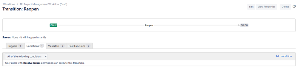

When we go to the Conditions tab in this same screen, we can see that there is a Condition that you have to have the 'Resolve issues' permission in the project to even be able to see this transition. Conditions check your access to the project or issue, and, on that basis, either show you the transition or not. Validators, instead, would show you still the possibility to transition the issue, to go back to the 'To Do' status, but if you didn't have enough permission, the transition would fail and you get an error message. For this reason, some people prefer to use validators as you can help users understand better why they can't do something, instead of just hiding stuff they shouldn't see.
