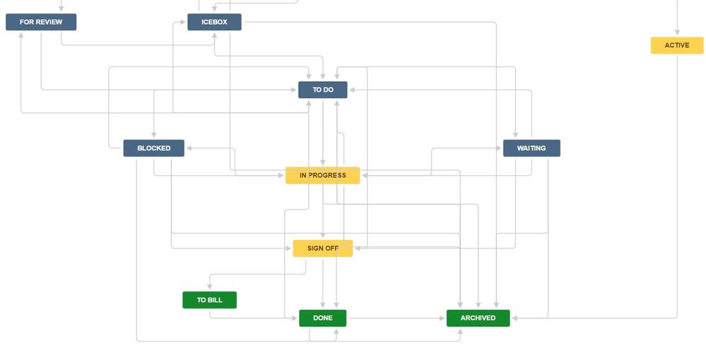

I literally went from In Progress or Waiting on old issues and went straight to Archived. We didn't set up the workflows in Jira, another company did, so I'm not entirely sure how these were set up. jira workflow.JPGarchived jira.JPG
Nic Brough -Adaptavist-
June 26, 2017
Ok, to get an issue out of your "archived" status, you need to have a transition out of it in the workflow, and have permission to use it.  It's hard to see from that diagram if there is an outgoing transition.
You'll need to get one of your administrators to edit the workflow - first to see if there is a transition (and then add one if there isn't) and then to check the conditions on it it and ensure you match them.

Hi Elizabeth,

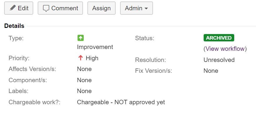

it seems, that your workflow has a "Dead End" in the Archived state. There's no transition going out of the state "Archived".
The cause, why your issues are still active in your views is, that they have no resolution set.

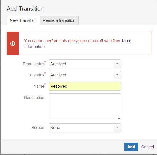

Thanks Nic. There wasn't a transition built in. I have admin access for the workflow, so I can build in the transition. I was speaking to someone in the office about how to build in a transition and we have an error saying we're editing a draft workflow. We've published it, it confirms it's published and then still doesn't let us save a transitiontransition.JPG
June 26, 2017
Ah, that old chestnut.
There's a horrid bug in JIRA that hasn't been stomped on for years.  When you have a step with no outgoing transitions, you can't add one while it draft mode.
You will need to copy the workflow.  Edit the copy, adding the transition, then create a new workflow-scheme (I would copy the existing one for the project).  This new scheme should use your new workflow.  Then apply the new scheme to the project.

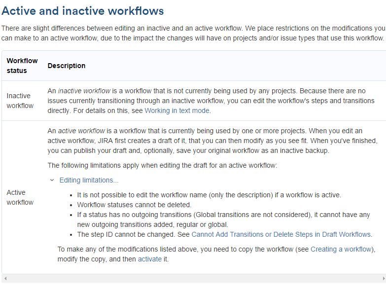

Liz
June 26, 2017
Also, just found this - Point 3 of the bullet. This sounds like you can't add in a transition in an active workflow and I tried to save a transition to a draft workflow and it says I can't save it to a draft one either....I am new to Jira, so apologies if I'm missing something obvious!
  • If a status has no outgoing transitions (Global transitions are not considered), it cannot have any new outgoing transitions added, regular or global.Info.JPG
