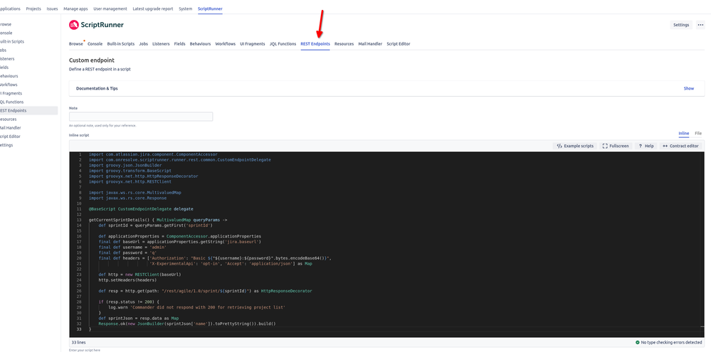

To answer your question, yes, this is doable using ScriptRunner for Jira DC. You will need to use 2 ScriptRunner components: the REST Endpoint and the Server-Side Behaviour for the Sprint field.
The REST Endpoint is required to obtain the details of the Sprint, and the Behaviour is required to perform the validation to check if the Project is associated with the Sprint and verify whether the issue can or cannot be added to the Sprint.
Below is the REST Endpoint code:-

Below is a screenshot of the REST Endpoint configuration:-

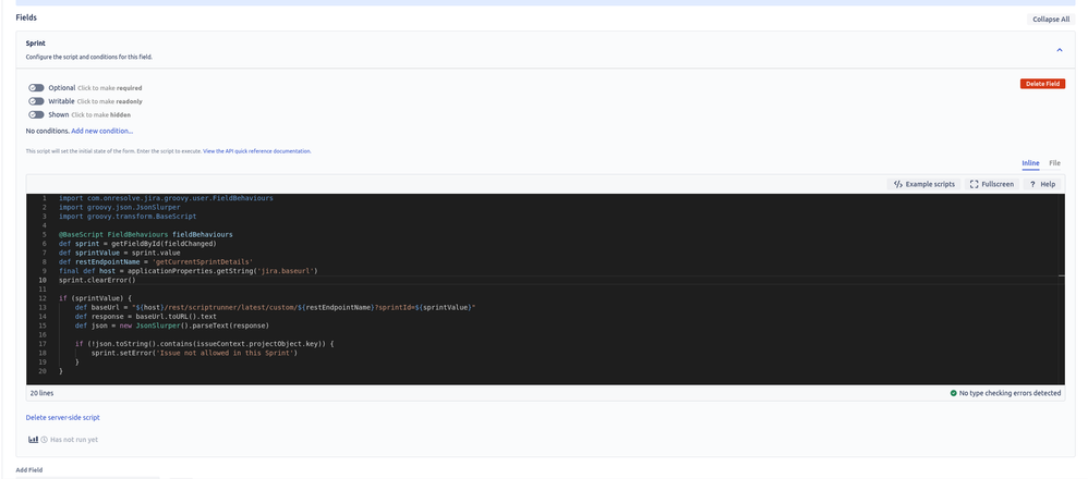

Below is the Server-Side Behaviour code:-

 Below is a screenshot of the Server-Side Behaviour configuration:-
Please note that the sample working codes above are not 100% exact to your environment. Hence, you must make the required modifications.
For the example code above, the Behaviour calls the REST Endpoint and checks to ensure that only Issues from the Mock project can be added to the Sprint.

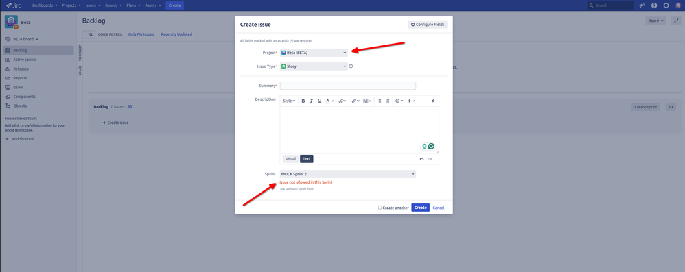

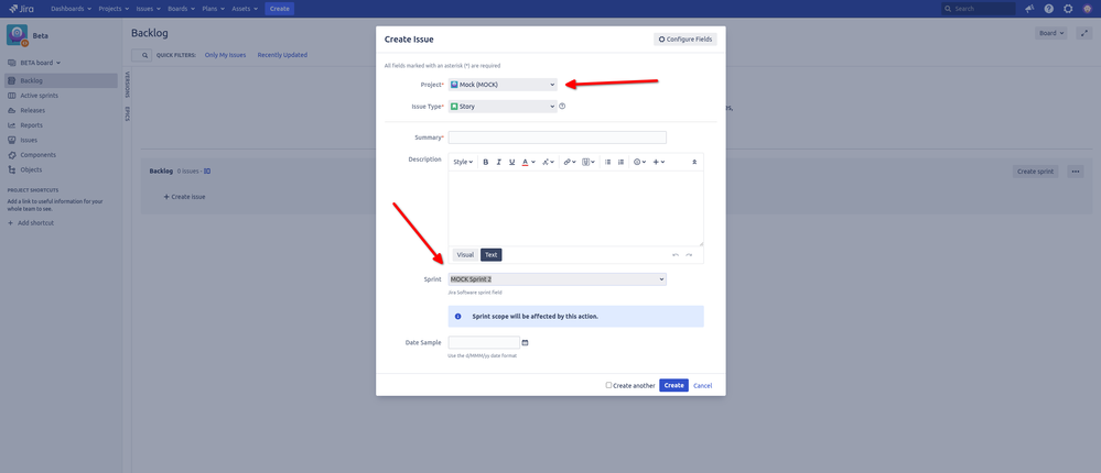

Below are some test screenshots:-
1. For the first test, I try to create an issue from the Mock project and select the Sprint from the Mock project as well. As expected, the Sprint that is selected allowed for the Mock project.
2. For the second test, I try to create an issue from the Beta project and select the same Sprint selected for the Mock project. As expected the Sprint is not allowed for the Beta project and a validation error message is returned as shown in the screenshot below:-
