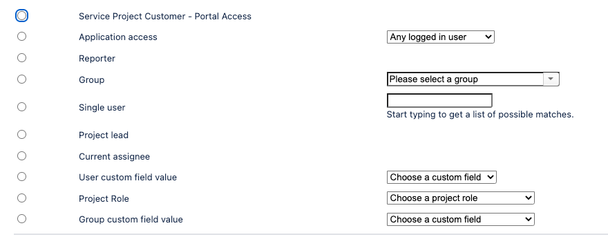

You need to figure out how you designate the "core team" vs. the "contributors" that should have limited visibility. These are your options that you can use to specify who can see an issue:

Are your "contributors" and "core team" contained in discreet user groups or project roles?
There are multiple ways you could set up issue security levels depending on how you use groups vs. roles. I can't tell you "do it this way" and guarantee that will work without knowing how your "core team" and "contributors" are being assigned to those groups and/or roles.

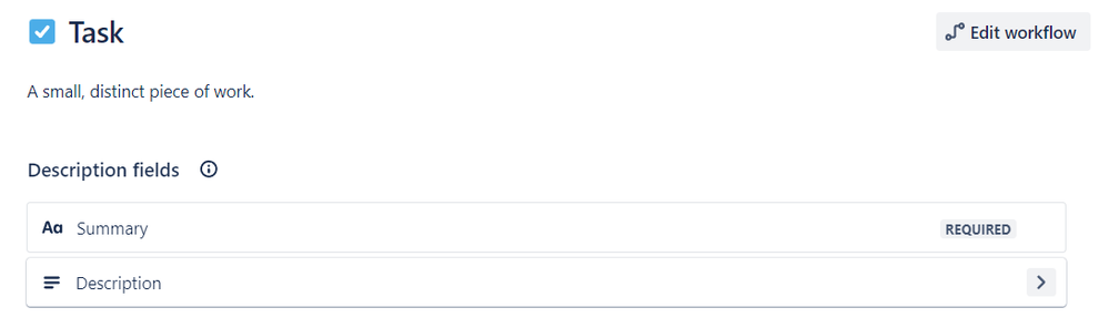

I've reviewed the resources you kindly shared, and I've noticed that we have not configured the "Restrict Issue" setting (see screenshots below).
While attempting to find out how to configure this setting, I came across a thread you replied to (https://community.atlassian.com/t5/Jira-Software-questions/How-to-enable-restriction-for-issue-ticket-of-Jira-Work/qaq-p/2243301) where you mentioned that this configuration was not available for Team Managed Projects. Perhaps this has changed since then. Could you please clarify?
