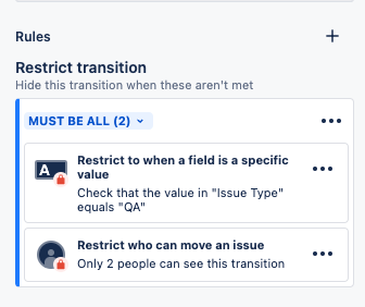

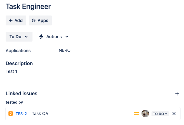

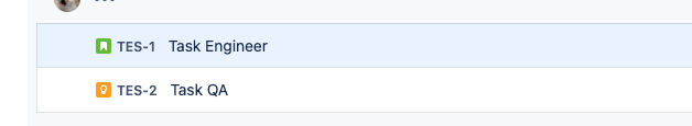

There is Ticket with issue Type Story and QA, I want ticket QA can be move to in progress if Task Engineer already on status Ready to Test.
Task engineer and Task QA already linked each other
how to add rules for this condition ?
I didn;t found this configuration as well, or this case is imposible ?
Thank you for advice

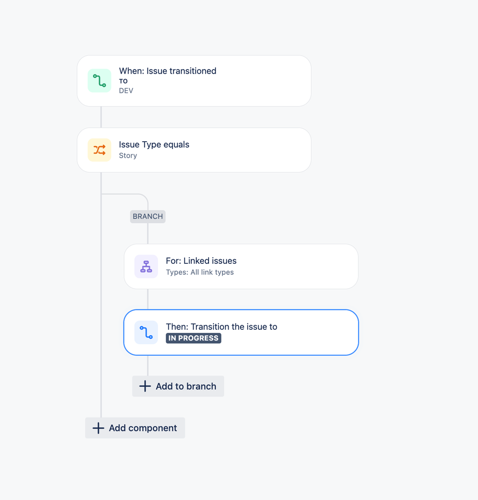

Hello ,
Welcome to the community :)
You could try this with automation
example below
So here when the parent issue is transitioned to dev status > check if the parent issue type is of the type story then transition its linked issue to in progress
Thank you,
