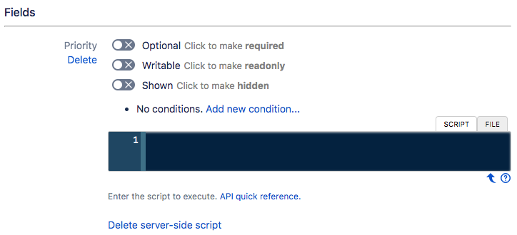

Thank you @PD Sheehan , this sounds great however I am struggling to follow what you mean by "add Priority to your behaviour configuration".
Are you referring to the Add Field section and then adding the Priority field? I have tried this and left all the available options off however this doesn't appear to have any affect. Am I missing something?

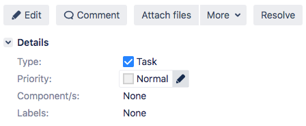

This is a screen shot of the area within Behaviours that I am referring to:
PD Sheehan
July 1, 2019
Yes, exactly like that.
Save your behavior configuration, then refresh your issue page and attempt to do inline edit of the priority field.
Assuming this is in the same config with the same behaviour mapping as the initialiser.

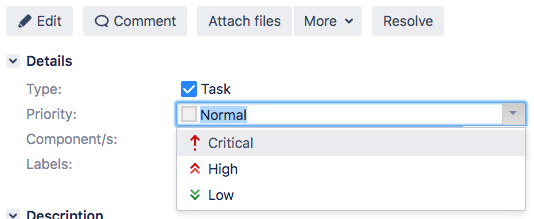

I have tried adding this to the same behaviour where I use the code in the initialiser in addition to having it as a standalone behaviour mapped to the same Project/Issues as my original behaviour.
On testing however I cannot get the desired affect either way, inline editing is still available.
