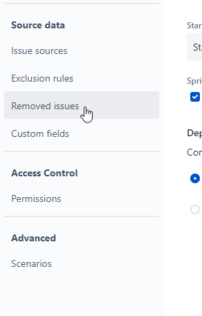

The only thing I can think of is that someone excluded them from the plan.  How do I restore them to the plan?

You go into the configuration options (the cog near the title) and it's a selection just below the data source you've set up.

There are no issues listed in the removed issues.  Also the Board shows the issues in question.  They are just not displaying in Roadmap.
