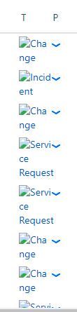

one more thing here, I have restored all images as per the old location but am not able to see images (Logos),

Ah, I was talking about attachments, not images you may have uploaded to replace/add icons for priority, issue type or other image based fields.  I can't remember where those are kept, even if they're under the home directory.
