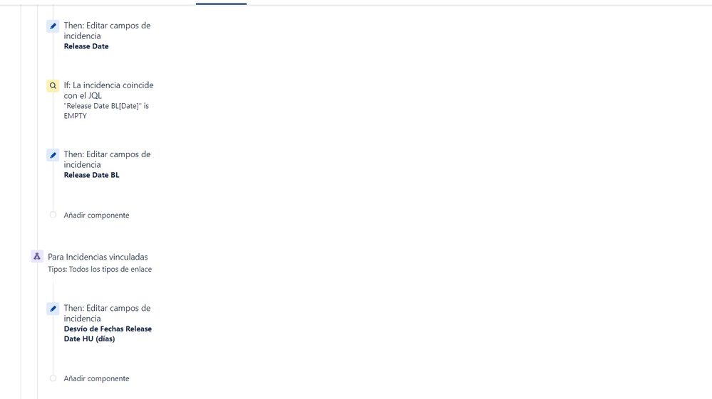

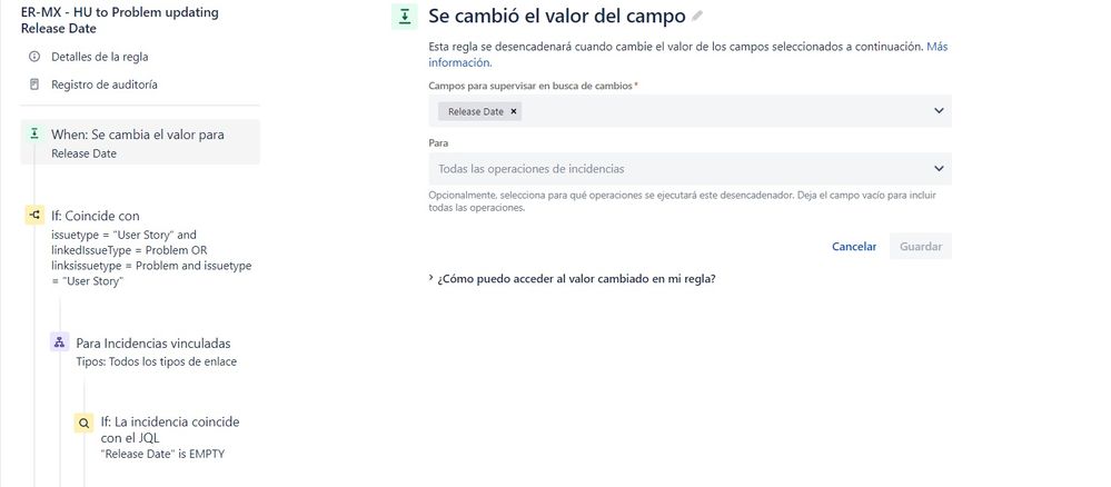

Hola @Bill Sheboy , agrego imágenes y el tiempo debe ser en Días pero solo hábiles digamos hacer una excepción   sábado y domingoRegla 1.jpgRegla 2.jpg

Thanks for that information.  I believe business days is one of the possible values for units with date diff:
{{issue.created.diff(issue.updated).businessDays}}
Have you tried that one?  If you did, were there any errors in the audit log?
