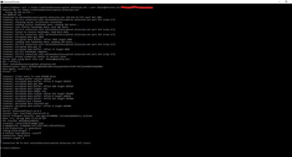

So I tried following the documentation for Generating API Tokens. I went ahead and generated an API token to connect Postman to our Jira Cloud instance. Afterward, I entered this cURL command:
curl -v https://nationalbusinesscapital.atlassian.net --user ibalas@national.biz:api_token
via Command Prompt and it seems to have authorized here. (See first screenshot below).

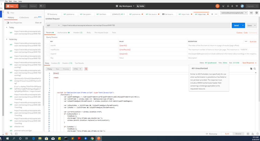

But then I went back into Postman and tried pulling one of the issues in my Jira instance and I was met with a 401 Unauthorized error (See 2nd screenshot below).
Hi @Ian Balas
So in Postman, under Authorization, there's a Type dropdown, you should have selected Basic Auth. What are you using?
@[deleted] I just figured it out.
I was using Basic Auth but was running the pull requests with my login credentials instead of the API token. I replaced my password with the API token and was successfully able to pull the work logs from one of the issues in my JIRA instance.
