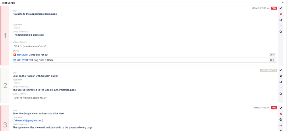

From the plugin UI, you can see failed steps in a script:
From these failed steps, you can create an issue that is connected to the steps.

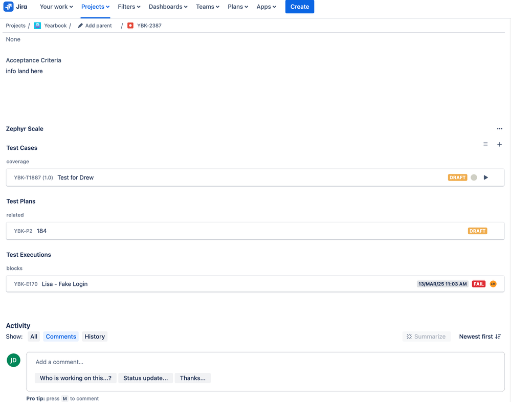

The metadata from the plugin will appear on the ticket as seen above. This is not available when you clone and cannot be copied from any fields as Jira doesn't seem to store any of the data from the plugin itself. In our workflow, these issue derived from failed testing should be subtasks on the failing issue/Story which disallow the parent issue from closing without first resolving the Defect/subtask. So, we need to be able to create subtasks from this workflow, but when you create an issue from the plugin UI, it pulls up the standard Create screen which doesn't and can't include subtasks.

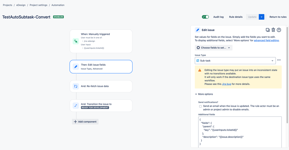

RE the failing automation itself, here's what the automation looks like and the errors I get.
Some notes:
  • The {{userInputs.ticketid}} in the JSON is the user-entered value for the what the Parent of the subtask should be. It will be a string like "ABC-123"
  • I made sure the workflows for both the initial issue (Bug) and the subtask (Defect) were the same.
  • I tested this manually to make sure it works manually, and that works fine.

Does anyone know what could be causing these errors or how to resolve them? My theory is that the automation is trying to change the issue type and set the parent in the same call. This means that the new issue type is not set first, so effectively, the automation is trying to make a Bug issue type the Child of a Story issue type which would cause the hierarchy error, but I'm not sure if this is true or how to fix it.

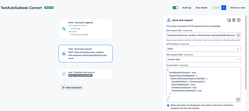

It worked; after many hours of painstakingly trying to figure out how exactly to use Jiras Rest APIs with automation of course. haha
For those wondering how this worked in practice, I got more errors than I can count just following the documentation, so here's exactly what I did that ended up working.
The JSON is:
"sendBulkNotification": true,
"targetToSourcesMapping": {
"EDZN,10076,{{userInputs.ticketid}}": {
"issueIdsOrKeys": ["{{issue.key}}"],
"inferFieldDefaults": true,
"inferStatusDefaults": true,
"inferSubtaskTypeDefault": true
What that will do is to:
  1. Set the parent = a text value entered in by the user. Here it's smart value "{{userInputs.ticketid}}"
  2. It sets the issue type you want to move to where you see "10076"
  3. Everything below just tells Jira for any required fields or statuses, use a default. I recommend this because trying to update any fields in the move itself gave me a nightmare list of errors. Instead, you should use subsequent steps in the automation if you want to update field values.
NOTE: There's a parameter to include in the body of the request that you can use to list out the issues you want to move. You might be able to populate a smart variable to get a list and plug it into the body. This automation only works for a single issue.

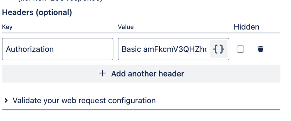

You NEED to have an authorization header.
Follow the steps on the page listed by Bill, but when you encode your data, don't include the <> characters from the example. I made that mistake and it left me confused for hours.
