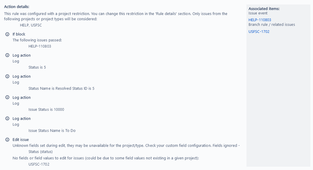

I am trying to resolve an automation error. The error is 'no fields or field values to edit for issues (could be due to some field values not existing in a given project).

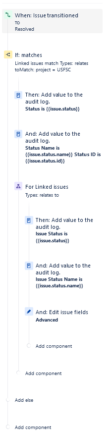

My rule logic is below. I suspect the difference in statuses is the reason for my error.
I have two projects that have different statuses.
  1. HELP
  2. USFSC
Objective: When I resolve an issue in the USFSC project if there is a linked 'relates to' issue I want to resolve the HELP project issue.

Hi Rodrigo,
That typically means that the field to update is not on the Edit screen or is not a part of the context for the field does not include the project and/or issue type used for the issue being processed.

You are trying to update the Status field? Why wouldn't you do an Transition Issue instead?
Rigo Angulo
May 24, 2022
I tried to transition in the issue in the past but no luck. I don't have the error from the past but I have just tried with the new action of a transition and its now working!
I appreciate all the help sir!
