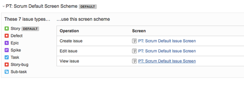

Soo I think we figured it out, my default screen for create, edit and view - had the resolution screen there, but it was hidden in the transition screens.
Screen Shot 2017-11-06 at 3.16.18 PM.pngScreen Shot 2017-11-06 at 3.18.41 PM.png
I removed the resolution field from this and now when I use the transition screens, resolution is not being set to the default as "done" anymore.  So even though the resolution field was not on the transition assign reviewer screens, it was selecting done on the backend since this was apart of my create, edit or view scheme and set to default to "done"
Not sure if any of that made sense, but short answer is "its fixed" and we verified with sever tickets.
Thanks soo much!

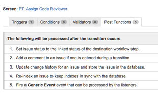

Hi all - I work with Molly and thought I would add a bit more detail.  Here is our setup -
Jira Cloud - Application 3.3.0-OD-1000.2449.0
Issue started appearing 3 weeks ago. Steps to Reproduce:
Issue Type: Story
Note: Resolution is "Unresolved" as expected
1. In active sprint view, drag a story from "In Progress" status to "Ready for Code Review"
2.  PT: Assign Code Reviewer screen appear
This screen is only shared with one project - ours, ProdTech, see below.
3. Assign a code review and tap "ready for code review"
Expected: Resolution states - "Unresolved"
Happens: Resolution states - "Done"
We have checked post function and there is no indication that resolution status is auto updated - at least in the frontend UI
Note: there is a trigger function, but this is only for pull request in BitBucket to update ticket status not resolution. User must assign a code reviewer  when moving in Jira
More Info:
I looked at the history and seeing resolution changing when user is assigned in any review state. We have Ready for Code Review (with tigger), Ready for Stakeholder Review and Ready For QA (both without triggers). All these statuses have a transition screens to assign a person but do not have a resolution field to update.
However, resolution is consistently being updated to "Done" on the backend somehow.
Also checked to make sure we only have a resolved state at the final status in the workflow:
Hope this helps to get more feedback and possible solutions. Its driving our team crazy and not sure how to resolve.
Thanks
Bill
