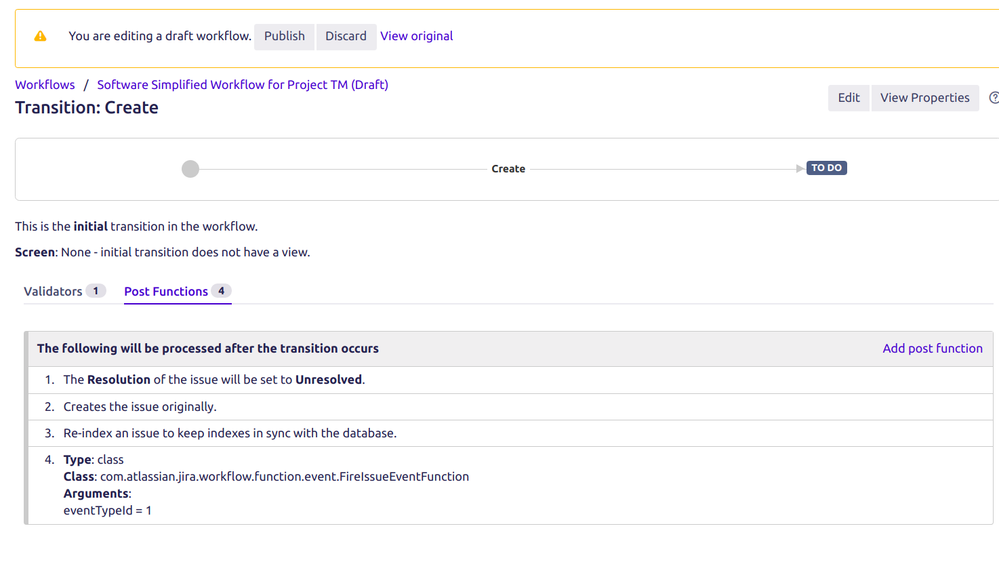

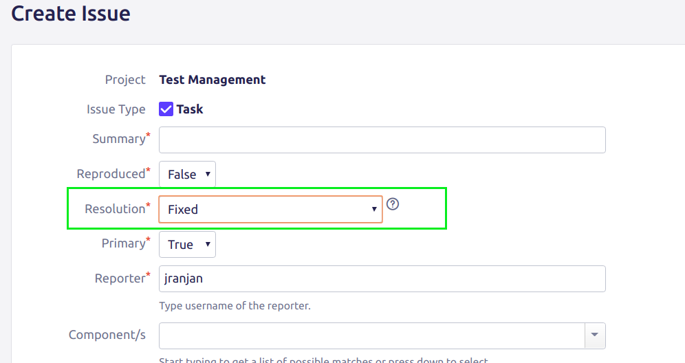

Deleted user
December 20, 2018
The same issue I'm facing
I have to set resolution field as "unresolved" while creating issue in post function.
but still i see "fixed" while creating issue. please help how to change the field value. attached the imge.
Nic Brough -Adaptavist-
December 20, 2018
I am sorry to have to say you have made a total mess of your configuration here.
To start to fix this:
  • Remove the "unresolved" resolution from the list of resolutions immediately, or at least rename it to "do not use this"
  • Delete that post-function from your workflow
  • Remove the resolution from all screens, except the "resolve issue" transition screen
You should NEVER have a resolution that means "unresolved".  Unresolved is indicated by the field being empty, not set to a value.  You should NEVER put the resolution on a screen that is used for create or edit.

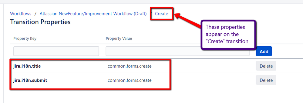

StephanieC
January 16, 2020
Nic - do these Properties do anything specific? Ive never noticed them on other workflows...I thought this might be what was resolving new tickets, since these properties arent in any of our other workflows:
January 19, 2020
Those two are translations.
Properties can, in some places, change the list of resolutions offered (shortening the list), but they do not set them.
Like StephanieC likes this
