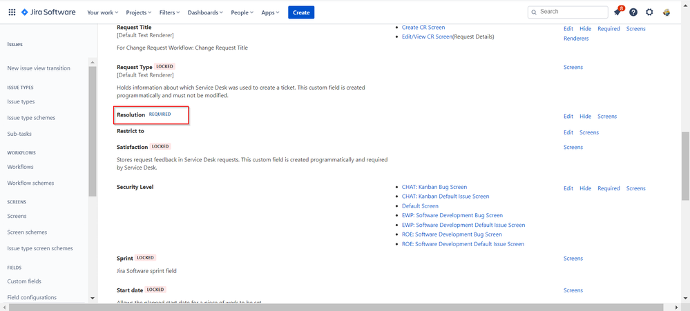

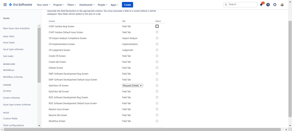

Thanks for your kind sharing! May I know how can I make it not appear as "Required"? I have unassign it from all the screens and also validators in the workflows but it is still displayed as required.
Reo Lim
April 26, 2021
MicrosoftTeams-image (1).pngfieldconfiguration.pngfieldconfiguration_noscreens.png
If we create issue normally, resolution is not required.
Ismael Jimoh
April 26, 2021
Hi @Reo Lim
That is weird that you are not prompted when creating an issue from the UI. However, as suggested, make this field optional as you shouldn’t be setting a resolution when creating an issue.
This means the issue is already fixed and it skews any reports you are working with since reports like Created vs Resolved assume that work has been completed.
