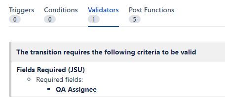

hmmm... and your sure this is a validator you have and not a condition. Sorry, just grasping here as I'm not seeing anything obvious. Maybe you could share some screenshots in hopes something pops for me. Workflow illustrating transition and validator.
Elena Kotsinova
December 7, 2020
Is this enough?

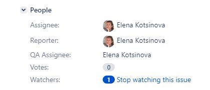

Susan Hauth _Jira Queen_
December 7, 2020
Hi Elena,
Is the user being properly entered during the transition.  I don't see an avatar for the user.  Maybe you could paste in what the field QA assignee in the issue view looks like when the user is specified?

Elena Kotsinova
December 7, 2020
@Susan Hauth _Jira Queen_ The user is selected from a list with users who are in role QA for the project.
I never seen avatar to be displayed on this custom field even when it works.

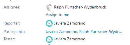

December 7, 2020
Hi,
Are you sure your field is set up correctly?  If it's a user picker, I think the avatar does show.  I have a customer user picker field tester.  Similar to your use case.  But this is how it looks on my screens:
