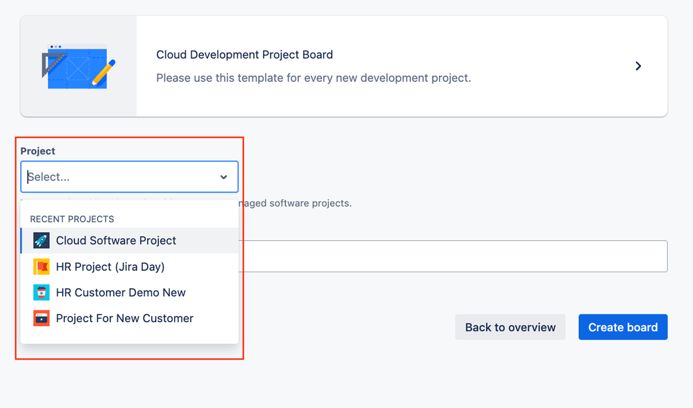

Hey @Norman Daryl Esponilla welcome to the community! ☺️
If you're open to using a third-party app for your cloud instance, I think board templates could be a good alternative.
  • You can easily create board templates from existing boards and add them to projects
You can find us at the Atlassian Marketplace ➡️ https://marketplace.atlassian.com/apps/1224664
This is how this might look like:
