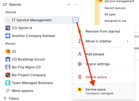

First, you must be working with a Service Management type of project.
Click the three dots next to the project name (in the navigation panel on the left) to open the pop-up that shows the project type and share that information with us. We need to confirm that the project is Service Management, and know if it is Team Managed or Company Managed.
The navigation path depends on whether the project is Team or Company managed, but starts with going to the Space Settings option in that same pop-up.
You must have permission to administer the project to access that first option. If you are an administrator of the JSM product you may already have the project administration permission.
If you can get that far, please share a screen image of the option you then see in the navigation panel on the left.

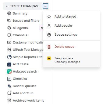

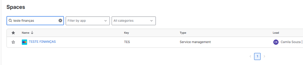

I confirm that we are working with a Jira Service Management (JSM) project, and I have checked that my profile has administrative privileges.

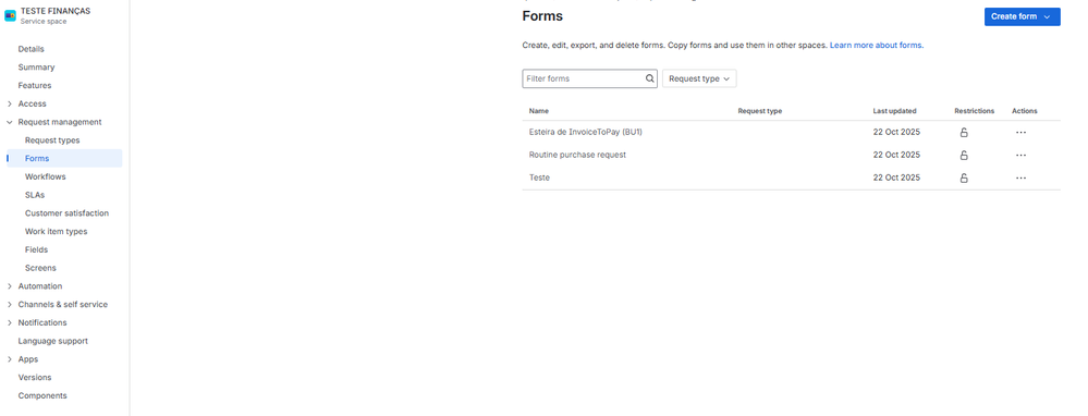

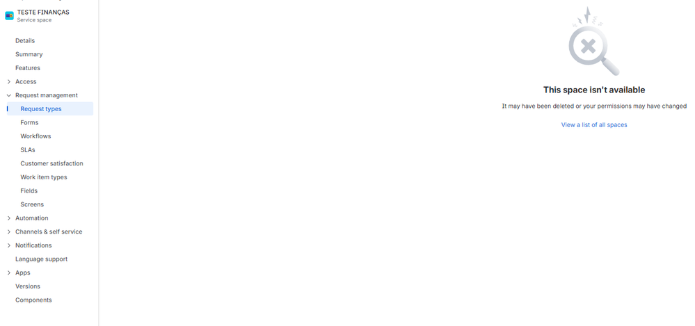

I've successfully created the forms, but I believe the issue is that I cannot link them to the Request Types due to a permission issue on the Request Types side.
I understand the need for the Admin permission and a JSM Agent license. Based on this, could you please confirm the exact steps after selecting Space Settings? I suspect I might be navigating incorrectly when trying to link the forms/set up the Request Types.
Please find the requested images attached for confirmation.
Captura de tela 2025-10-27 172457.pngCaptura de tela 2025-10-27 172941.pngCaptura de tela 2025-10-27 172853.pngCaptura de tela 2025-10-27 173027.png

Check the Permission Scheme for the project. There is a permission named Service Project Agent. Make sure that you have been assigned to a role or group that has been granted that permission.
Being a Jira/JSM Product Administrator will give you access to the Space Settings for the space/project, but does not automatically make you a member of roles within the project. You will need the above permission. As a Jira/JSM Product Admin you should be able to assign yourself to the necessary project role in the project.
