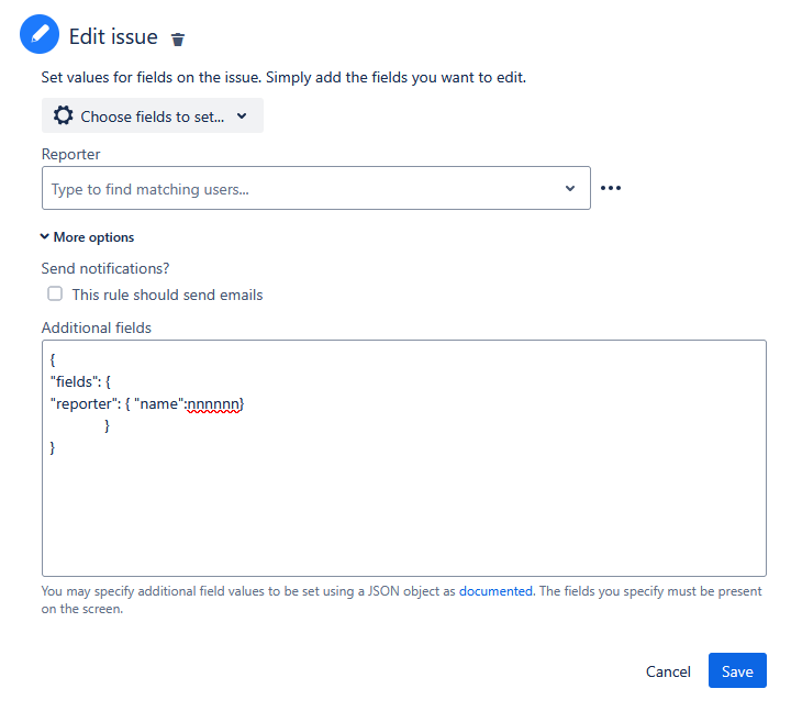

I am having my own customers list made available in my JIRA instance. I like to have the customer name I selected as "Reporter" in my JSM issue.
I tried to apply smart value, but always I get "Anonymous" as value updated in my issue.
My Json
"fields": {
"reporter": { "value":"{{issue.customfield_10205.value}}"}
added screen shot, so you can point me what changes do I need to do.
Note: User I selected is part of the JIRA address book. Eventually I like to have reporter as Non JIRA user as they are outside of our org structure.

"fields": {
"reporter": { "id":"{nnnnnnn}" }
I have person's Full name, email ID, Account short ID. I tried above, but got an error "Error while parsing additional fields. Not valid JSON." Tried with email ID as well.

I tried 2 options:
option 1:
"fields": {
"reporter": { "name":nnnnnnn}
Option 2:
"fields": {
"reporter": { "name":nnnnnnn.nnnn@gmail.com}
Trudy P Claspill
February 18, 2026
First question, does the specified person have a User Account in your Jira instance?
Second question, if you go to one of these issues in the UI are you able to manually change the Reporter to the specified user?
Third question, when you say you used the "ID", does the value match the username shown in the user's profile in Jira?
If the answers to all the above are Yes, then this is the correct syntax:
"fields": {
"reporter": { "name":"username"}
You cannot set the Reporter field using a user's email address. You have to use their username or the unique numeric ID set for the user when their Jira account was created.

Suresh Srini
February 19, 2026
Thank you.
nnnn OR nnnn.nn@gmail.com is the actual user registered in my environment.
Yes. I can change the reporter to the issue with this user ID. Below is the error even after having closing }. When I say login ID OR JIRA ID,
"fields": {
"reporter": { "name":nnarayan}
Trudy P Claspill
February 19, 2026
You need to put double quotes around nnnnnn
"fields": {
"reporter":{"name":"nnnnnn"}
Like Suresh Srini likes this
Suresh Srini
February 19, 2026
Thanks a ton, it worked. Really appreciate it.
