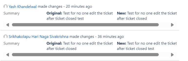

I have tried to set the property in the workflow but that's didn't work can you please help me on this.

Hi,
If we are not adding the (") in jira.issue.editable this propertied so we can't able to create the workflow properties. Already tried in the transition as well as in the status.

Could you please confirm in which jira version you are trying.
I am using this in 9.12 version.
