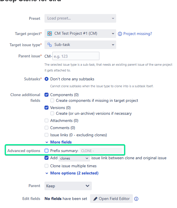

With our Deep Clone for Jira, you can swap the default “CLONE –” prefix for the value of your Customer name field while you clone:
When cloning with Deep Clone, you can disable the prefix option, so no prefix is set.
Then you can use the Field Editor feature with a Jira expression like this
issue.customfield_12345 + " " + issue.summary
The clone will be created with the customer’s name at the front instead of “CLONE –”.
Need this to run automatically? Add a Deep Clone Post Function to the appropriate transition and select the preset—keeping your workflow clean and completely no-code.
