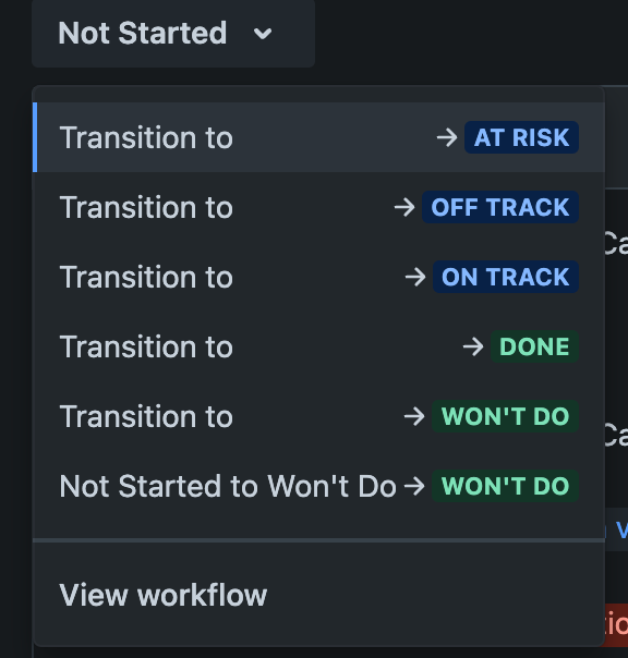

Does anyone know how to remove the "Transition to" and arrows pointing to each status in the UI? I created a new workflow and applied it to a single issue type, then noticed the status options looks like this now. I've never seen it before and can't seem to find any way to get rid of it. Thanks!

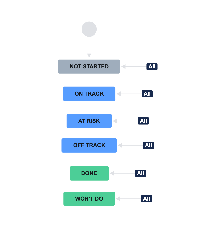

Hey all. I figured out the solution to this thanks to what @Alex Koxaras -Relational- had said. I had transitions connecting a few of my statuses to "Won't Do" to enable a Resolution screen to pop up. This would require the user to choose a reason why that issue was marked as Won't Do.
It turns you don't have to link those statuses with transitions and all that's required is to allow all transitions to be moved to Won't Do, then add the Resolution screen when editing the "All" transition that is tied to Won't Do. This will require any issue transitioned to Won't Do to choose a Resolution option.

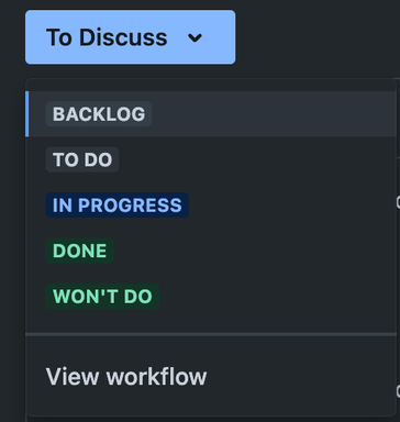

thanks @Alex Koxaras -Relational- ! In our company-managed project, we have other workflows with issue transitions that show up like this. I was curious if there was some setting I need to adjust to get it to look more like the screenshot below.

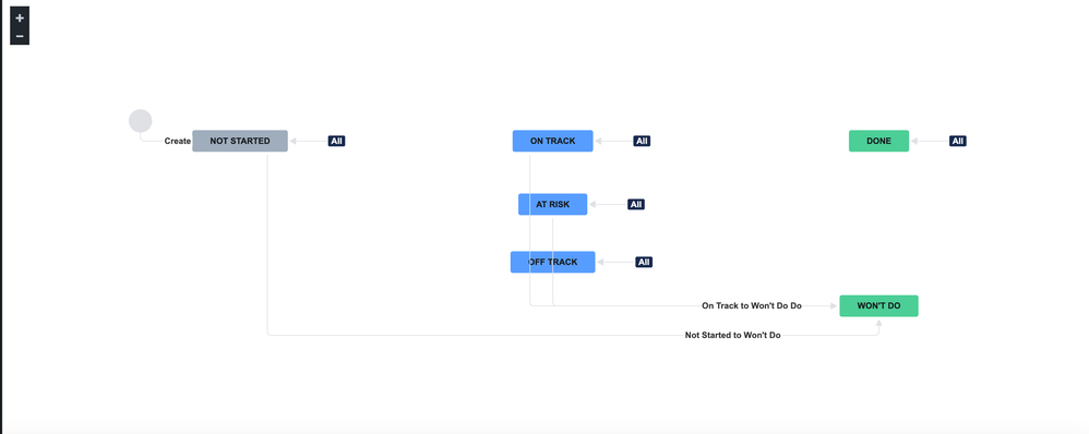

@Alex Koxaras -Relational- This is the current workflow that I have published.Screenshot 2023-02-18 at 2.53.38 PM.png
It's show the possible status transitions like this in the Issue View.
Trudy P Claspill
February 18, 2023
Hello @David Calabrese
In Company Managed Software projects I see just the available Statuses in the dropdown.
But in Company Managed Service projects I see the Transition name, an arrow, and the destination Status.
I never noticed the difference in presentation between the two types of projects before. I'm not sure if that is a recent change, or if I just never noticed it.
