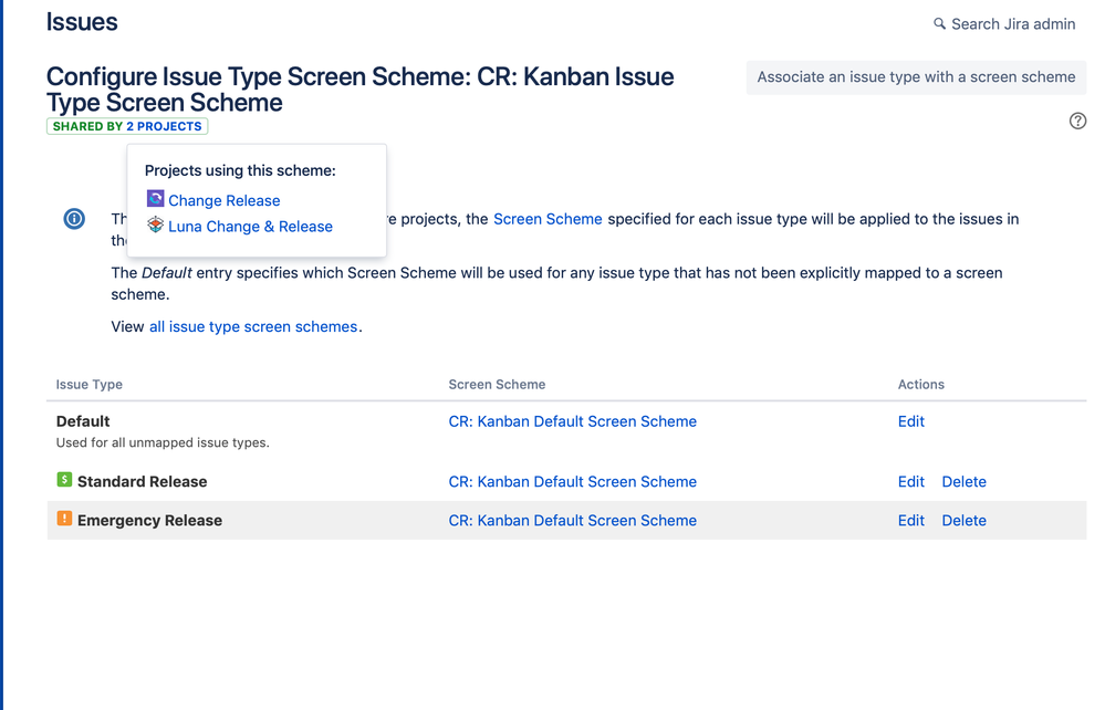

Hi There,
How do I remove my project (Luna Change and Release) from the CR: Kanban Issue Type Screen Scheme shown in the screen shot, I can't see where I can simply remove my project from the screen scheme. Edit doesn't give the option, also under configure its not apparent where to remove my project see second screenshot as well.
Mikael Sandberg
November 19, 2019
In order to remove the project from that issue type screen scheme, go to your project settings and change which screen scheme your project is associated with.

Shaun Morgan
November 19, 2019
Thank you so much that was driving me insane.
