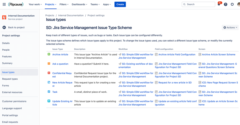

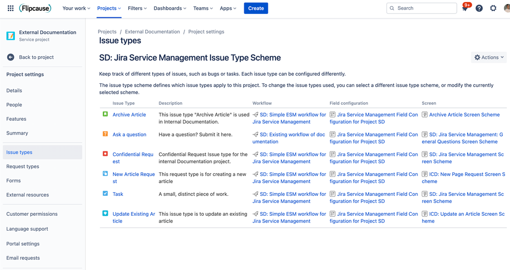

We have created two service management one is the internal document (ID), and the other is the external document (ED), but creating a new project I shared the existing project setting with the other. Now I want to remove two issue types linked with ID i.e. Task and Ask a Question, but that same is linked with ED. Is there is way to remove the issue type from the ID project without affecting the ED project?
Can you Please provide the solution for how I completely make the ID and ED
projects independent?

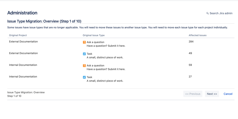

I just wanted to confirm that this change in ID will not affect the External project (ED) and the associated tickets because I tried this, but it's showing this (in the screenshot below).
Can you help me make the projects ID and ED completely independent?
Kai Becker
July 26, 2023
Hi @Shikha Verma
did you copy the issue type scheme?
You should only modify the copy of the issue type scheme.
After modification of the copy, assign the copied scheme to the ID project.
Are you sure, that you have done all these steps correctly?
Rilwan Ahmed
July 27, 2023
Hi @Shikha Verma ,
  1. Run 2 JQLs in ID project --> Bulk edit --> Move existing tickets to required Issue types.
    • project = ID and type =Task
    • project = ID and type = "Ask a Question"
  2. You should map the copied and modified scheme to the ID project.
