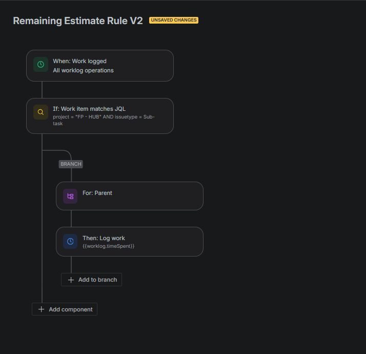

I am trying to set automation rule that will enable me to get hours logged into sub-tasks to my main story, so that remaining hours are decreasing.
I created below rule, but when this runs my hours spent are doubling.
Is there anything I can do to ensure that when this rules runs worklog from sub-task is getting deleted ?

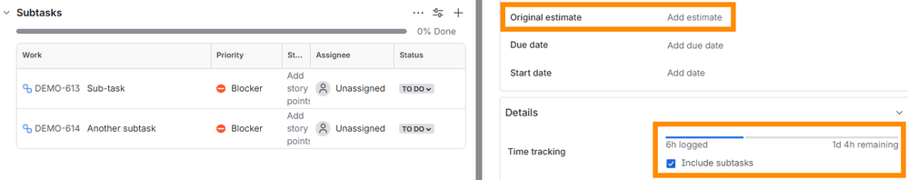

Maybe you don't need an automation for this.
Here's my observation, I hope this helps:
On the parent story 'Time tracking' field, check 'Include subtasks'. The logged time and remaining estimate will be the sum of for the subtasks.
If you don't estimate your parent story, it will be just the sum of the sub-task estimates minus the logged time on the sub-tasks. If you also add an estimate to your parent story, it will be: parent-original-estimate + sub-task-original-estimates - parent-logged-hours - sub-task-logged-hours.

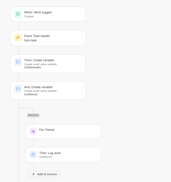

Here is the working version, tested on my side.
Trigger: Work Logged Created
Condition: Issuetype = Sub-Task
Create Variable: wlStarted - {{worklog.started}}
Create Variable: wlSecs - {{worklog.timeSpent}}
Branch: For Parent
Add Log Work: Time Spent - {{wlSecs}}
                         Date Started - {{wlStarted}}
Let me know if you have any questions.

I have re-created your set-up, but it works exactly the same way mine did. Once I log time on the sub-task the hours spent would be multiplying.
I was hoping to arrive at the set-up where if someone adds time to the sub-task let's say 1h, then on the story it will be reflected as 1h less of remaining time. Instead I have 2 hours added in (I am aware of tick-box) but using reporting tools such as eazybi would be tricky in this context.
Do you think there is a way to delete worklog on the sub-task once automation for remaining time is finished ?

In this case, I think you can do that without automation.
Just no need to estimate the parent ticket, check the "Include subtaks" checkbox, which will calculate the sum of the sub-tasks' original estimate and time spent.
If you are also estimating the parent, you just need to divide the number by 2 :D
In our company, we are just estimating the sub-tasks and seeing the progress on the parent ticket.
Also, the same as @Bert Dombrecht suggests.
