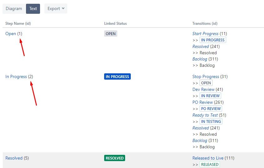

Looking at the workflow in Text mode will have the status id for each one, so you should be able to get the id for No-Run - see below.

Yes that's a screenshot from one of my workflows, as an example. If you (or an Administrator) look at your workflow, you should be able to get all the status ids.

Hi @Esther Evangeline. V
You may need Admin rights to do this, but try …
Click on the gear icon and choose Issues
From the left hand menu, click on Workflows
On the row for the workflow that you're interested in, click Edit on the right hand side.
Near the top of the screen that opens, there is a button for Diagram and one for Text.
Diagram mode will allow you to see the transitions and what is / isn't allowed.
