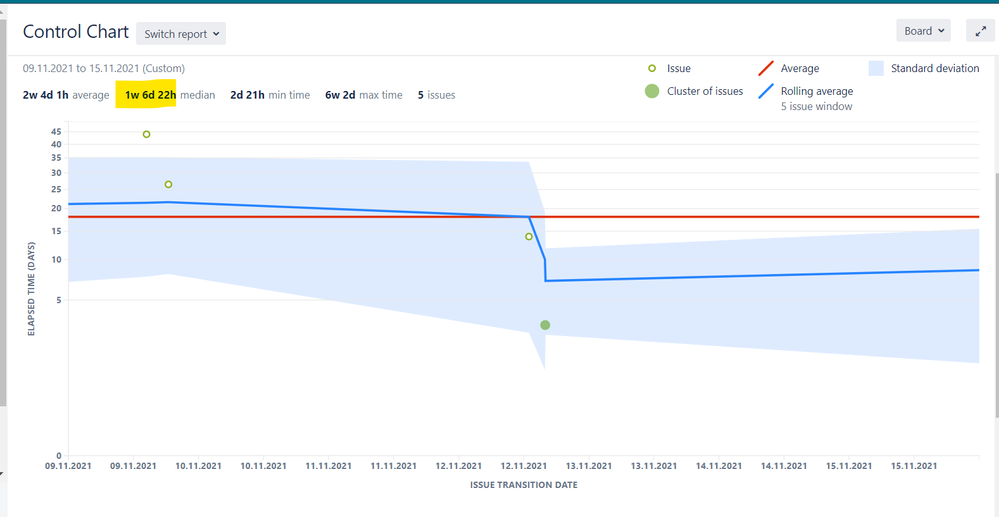

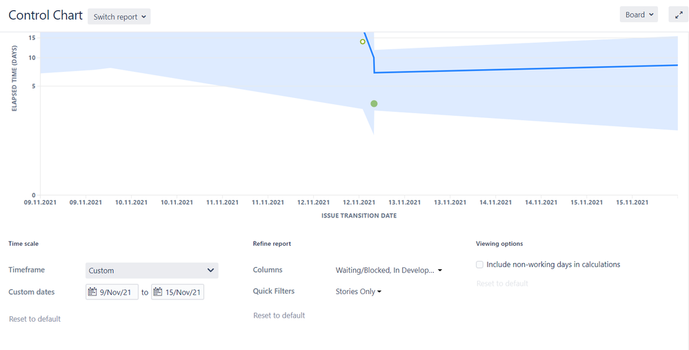

Hi Team,
When creating reports with Jira (control diagram) and checking for cycle times, I sometimes get results like 7w 5d 5h when I explicitly exclude workfree days (corresponding checkbox not checked). How is this possible? In the example it should read 8w 0d 5h since 1w = 5d = 24h.
Please refer the below attached screenshot:-
Highlighted time should show 2w 1d 22h.
Thanks

February 7, 2022
Hi @balaji
Some things of note when using Atlassian's interpretation of a control chart:
  • Their "cycle time" measurement uses date/time events and the Jira settings for working days and hours.  So there could be more/less days than you expect if the events occurred outside of the normal working hour boundaries that Jira uses, 9 AM - 5 PM with 5 days per week: Monday - Friday.  It does not use 24h days.
  • In your example about working and non-working days, do you mean weekends only or also the non-working day settings for the project?
  • You have highlighted the median value, which would be the middle value for all issues noted (for the data range and filter), yet that does not match the differences you noted.  Did you highlight something else?
