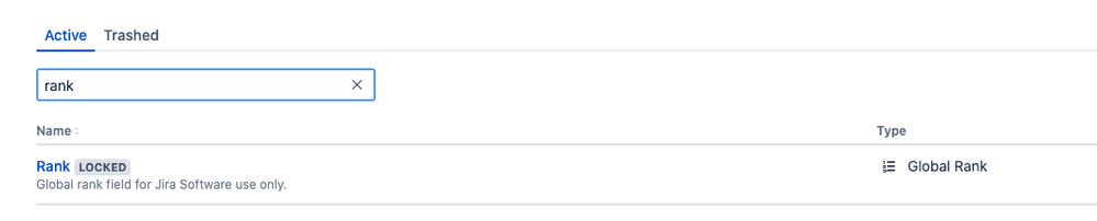

It also appears that somebody may have added another custom field to your system and named it Rank, causing two fields to exist with the same name. You will likely need to get rid of that second custom field that has the same name. You should be able to find both fields in the Custom Fields list available from Settings > issues > Custom Fields. The original Rank field should look like this:

finally, I realized that there were two fields with the word "rank" and one of them was edited to solve this problem.

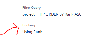

Does your filter have Order by Rank on the end of it?
Natalia Rodríguez
May 27, 2021
Hi @John Funk !
Yes, now the filter appears like this:
I guess that was your question, you mean that right?
