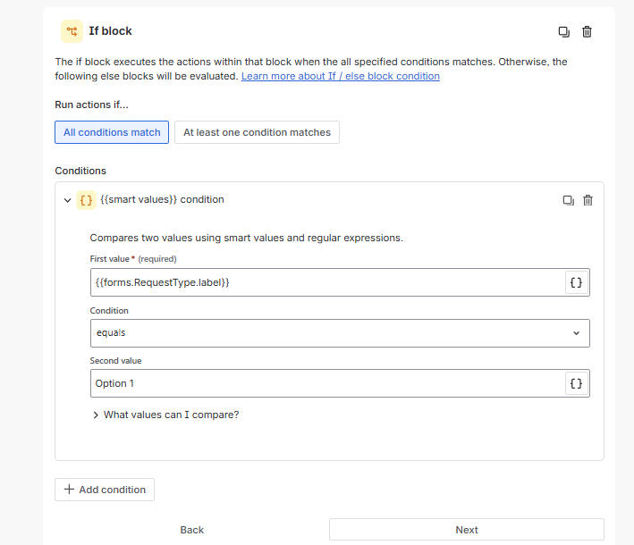

in the automation i have an IF/ELSE logic whereby
{{forms.RequestType.label}} equals Option 1 (have tried as "Option 1", "Option_1")
then send email with specific description
else, send an email with different description

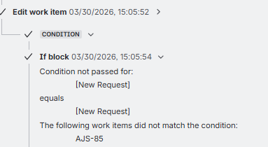

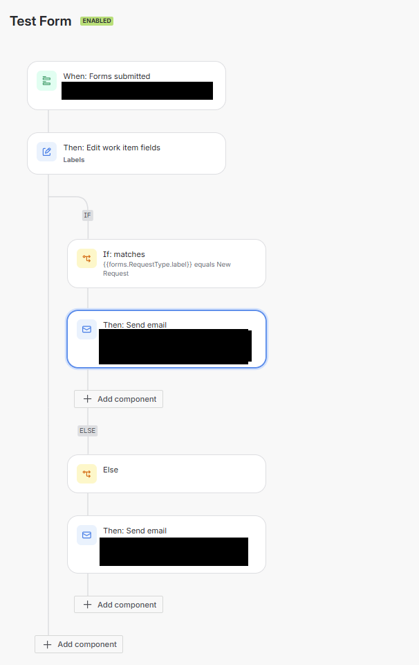

it is a company managed space and a screenshot of the automation is below
Option 1 is actually "New Request" in my automation and form (i was using option 1 to make it more generic in my original post)

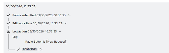

Can you add a Log action before the IF block to print into the log the smart value you are using in the condition? And then run another test to trigger the rule and share the results with us.
Anthony Pugliese
March 29, 2026
@Trudy P Claspill , i've tried a few scenarios using this [New Request] whether within brackets or not

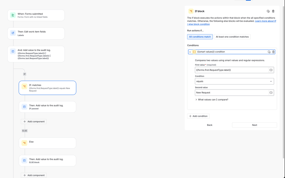

Trudy P Claspill
March 30, 2026
Hello @Anthony Pugliese
I'm glad you found something that works for you
However, I have not been able to recreate the issue you encountered. Using {{forms.first.RequestType.label}} directly in the compare in the IF block works for me. It fails only when I use {{forms.RequestType.label}} without including ".first" or ".last"
