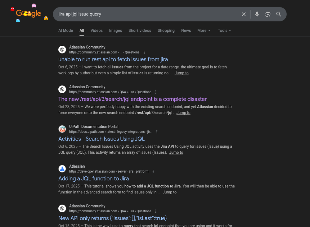

Agreed, this is frustrating. Providing easy to find clear documentation which is current is essential for cloud platforms as third party guidance consumers can Google for is often out of date. Also, using AI to create a basic framework to access data via the APi is hopeless making Atlassian API usage appear orders of magnitude less productive than other work.
Google concurs this is a "complete disaster" too:
