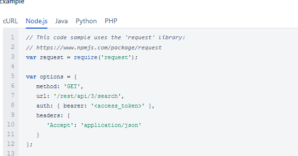

I am trying to get the issues list from JIRA by using the following POST request in nodejs.
Issues exist in JIRA, but the REST API response shows no results. Am I missing anything here to add/configure on JIRA?
Here is the code:
var request = require('request');
var bodyData = `{
"expand": [
"names",
"schema",
"operations"
"jql": "order by lastViewed DESC",
"maxResults": 10,
"fieldsByKeys": false,
"fields": [
"summary",
"status",
"assignee"
"startAt": 0
var authToken = Buffer.from("<EMAIL_ID>:<API_TOKEN>").toString('base64');
var options = {
method: 'POST',
url: 'https://<CUSTOM_SITE>.atlassian.net/rest/api/3/search',
authorization : 'Basic ' + authToken,
headers: {
'Content-Type': 'application/json'
body: bodyData
request(options, function (error, response, body) {
if (error) throw new Error(error);
console.log(
'Response: ' + response.statusCode + ' ' + response.statusMessage
console.log(options);
console.log(body);
API Response is:
{"startAt":0,"maxResults":10,"total":0,"issues":[]}

@WarrenThanks. Initially, I tried using "GET" method, but it did not work. So, I switched the request to "POST" as provided in the JIRA documentation for submitting the search parameters - an alternative to "GET" method.
One thing I just happen to notice on the API token page is the status of token shows that it was never accessed. Does it mean that the authentication did not happen even when the authorization info was sent in the request header?

Yuvaraj M
July 11, 2019
@WarrenThank you. I have located the defect on my code after a few tries on the Postman tool. I am able to get the results now. The fix is place the authorization key inside the headers:
headers: {
The documentation on the JIRA REST API for Node.js is misleading where the authorization key is placed outside the headers - https://developer.atlassian.com/cloud/jira/platform/rest/v3/#api-rest-api-3-search-get
