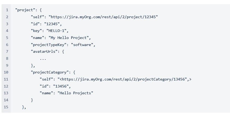

For 2 of our customers, who are running Jira server on-premise, versions 8.13.10 and 8.13.8, GET request sent to https://<jiraServer>/rest/api/2/issue/{issueKey} returns with fields.project.projectTypeKey, as shown below. The project object shown below is inside the fields object in the issue-by-key-response. You can see projectTypeKey = software in the response.
However, for another customer, who is running Jira server on-premise, version 7.6.4, the same request does not return the projectTypeKey.
For all three servers, the Jira REST API v2 is functional. So, how is it that the response from 7.6.4 is different than 8.13.x? Did the response change from Jira server 7.x to 8.x, even though the API version remained the same (v2)? Can you please confirm this?

I have not found the exact version where this change first happened.  But I have confirmed that Jira 8.0.x also displays this projecttypekey in the response of the GET issue endpoint.  I suspect that this change was made as part of a major version upgrade to 8.
However so far, I have not found a specific feature or bug fix ticket that accurately documents this specific change.  Minor changes like these are not uncommon to see within the Jira server REST API.  Unfortunately, the documentation space that provides examples of json responses, has not been updated to reflect this change, and in turn it isn't clear exactly which version this change happened in.
