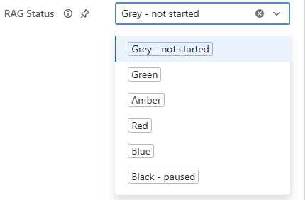

Hi Nikola thanks for replying.
The RAG status' we use are in the "Details" side of the card and are a drop down option when you click into it.
This is what it looks like if that helps:
For us Green is on track, Amber is slightly off track and Red would be seriously off track and causing a considerable risk. We'd also use Blue for Completed/Delivered

So this is actually a drop down custom field and you want to have these options to be colored. I'd recommend Awesome Custom Fields app from Atlassian marketplace. Jira doesn't have the functionality to add the colored dropdown custom fields.

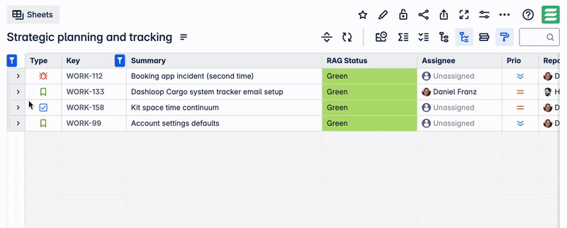

... and just to expand on my last point, this is how this could look in the app that my team and I are working on: JXL for Jira.
Put simply, you'd create a sheet with all issues that are potentially relevant to you, enable the default issue hierarchy (that's just one click), and then use JXL's filtering capabilities to narrow down to the issues that you care about:
Once you have your list of issues, you can work on these directly in JXL (much like you'd do in e.g. Excel or Google Sheets), trigger various operations in Jira, or export them for further processing.
