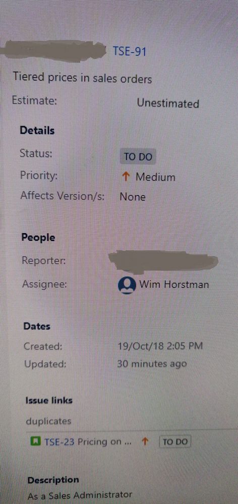

I use:
issueLinkType = 'duplicates'
Syntax is correct but the Quick filter does not give the expected result.
There are several issues with Issue Links of the type Duplicate but the filter gives zero results.......
What do I do wrong?
That's hard to tell without being able to see your data. Can you have a look at an issue that you would expect to see in the filter results and verify how exactly the name of the link is displayed?
Is it 'Duplicates', 'duplicate', ... ?

I think you should double check outward link description for Duplicate.

What do you mean by "double check outward link description" Do you mean the correct spelling? If so: I checked that.
