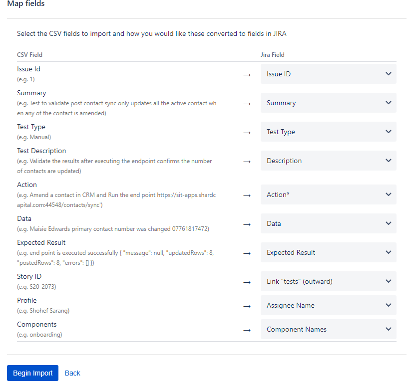

Shohef Sarang
August 9, 2023
Hi @Marc -Devoteam-
I am uploading a CSV file. please find attached example of the CSV file.
Configuration this in Xray.
I have been doing this for a while never had this issue and error message. So I was wondering anything in the settings I need to change.

Marc -Devoteam-
August 9, 2023
Hi @Shohef Sarang
I see no issues in your file and mapping.
I would reach out to Xray and present them the issue. They might be able to see if there is an issue on their side.
