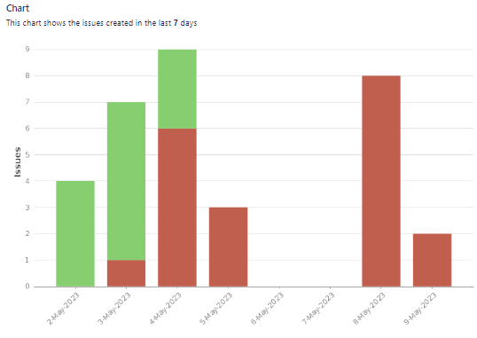

This is very much similar to "Recently Created Issues Report" that jira provides, but I need this in a form of gadget in my dashboard. Now I can use "Recently Created Chart" gadget, but I need the query to create the filter which could be used inside this gadget.

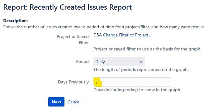

I wanted something similar to what Jira provides in "Recently Created Issues Report" as shown below. And for this, I needed the query to help me achieve the required filter.
