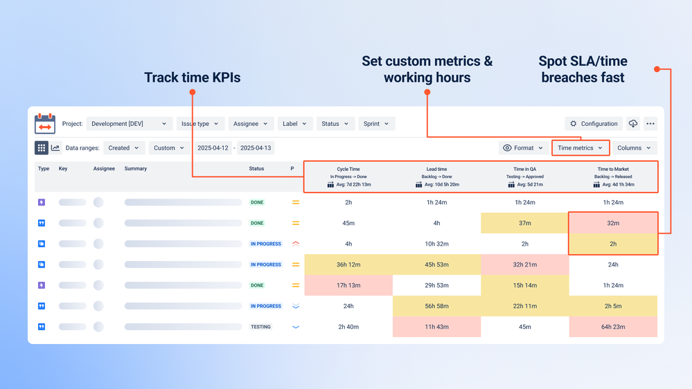

If you're open to solutions from the Atlassian Marketplace, you may want to have a look at the app that my team and I are working on: JXL for Jira.
JXL is a full-fledged spreadsheet/table view for your issues that allows viewing, inline-editing, sorting, and filtering by all your issue fields, much like you’d do in e.g. Excel or Google Sheets. It also comes with a long list of so-called history columns that aren't natively available, including the time in [status], time between [creation or status] and [status], and many, many more.
This is how it looks in action:
As you can see above, you can easily sort and filter by your history columns, and also use them across JXL's advanced features, such as support for (configurable) issue hierarchies, issue grouping by any issue field(s), sum-ups, or conditional formatting.
