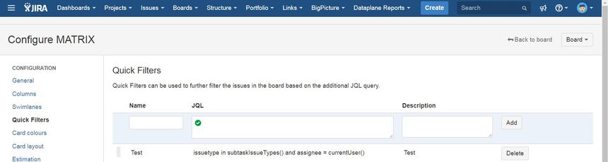

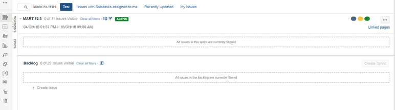

I'm afraid those screenshots are not relevant.
Could you run a search (not a quick filter) for that query?
And show us the plain issue view of a sub-task you are saying is assigned to you but does not appear on your board?

Hi Nic,
When I run a search I am able to see the results. All the sub-tasks assigned show up.
Is there any way I can do the same with a quick filter on the board?
