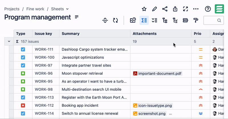

if you're open to solutions from the Atlassian Marketplace, this would be easy to do using the app that my team and I are working on, JXL for Jira.
JXL is a full-fledged spreadsheet/table view for your issues that allows viewing, inline-editing, sorting, and filtering by all your issue fields, much like you’d do in e.g. Excel or Google Sheets. For attachments, JXL offers a text search in which you can simply search by the file name or file extension, or even regular expressions for more complex use cases.
This is how it looks in action (I don't have a Figma file in my Jira site, so using Sketch instead):
I should add that JXL can do much more than that: From support for configurable issue hierarchies, to issue grouping by any issue field(s), sum-ups, or conditional formatting.
