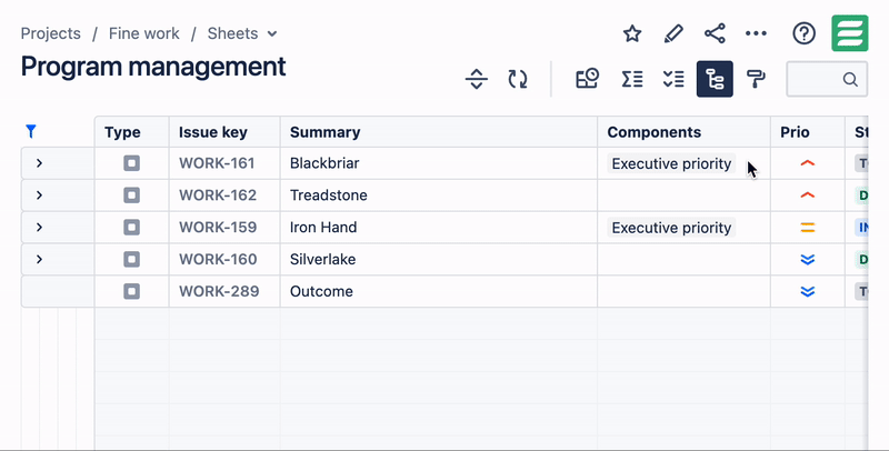

Just to expand on the last point, this is how this would look in the app that my team and I are working on, JXL for Jira. Put simply, you'd create a sheet with all issues that are potentially relevant to you, model your hierarchy (that's just a couple of clicks), and then use JXL filtering capabilities to narrow down to the issues that you care about:
(I'm using components here, but it would work the same way with any other field.)
Once you have your list of issues, you can work on these directly in JXL (much like you'd do in e.g. Excel or Google Sheets), trigger various operations in Jira, or export them for further processing.
