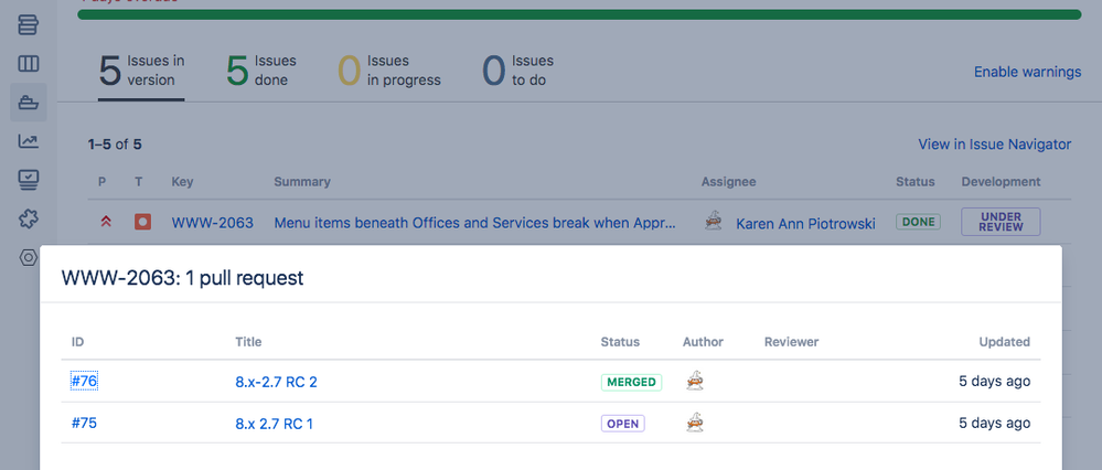

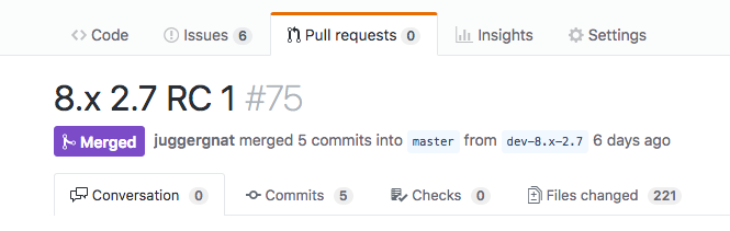

I am also experiencing the issue described in the original problem.
Let me show two images to visually describe the problem.
In this first attached image, you can see that the "Development" column in the Release shows "UNDER REVIEW" and the details show that pull request "8.x-2.7 RC 1" is listed as open.
In this second attached image, you can see that this pull request is, in fact, merged. However, I cannot get Jira to recognize that it is merged.

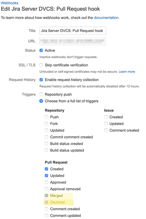

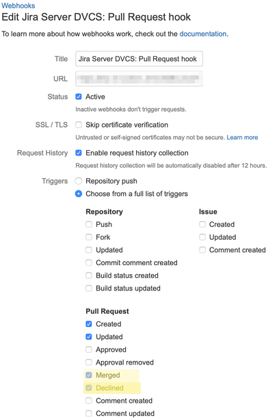

Same problem here. I'm using Jira Server 8.5.1 with BItbucket Cloud. When the pull request on Bitbucket becomes "Merged" Jira doesn't get it. I have to switch to administration menu and enforce the sync of the particular Bitbucket repository with Jira. The Jira issue get's the right state then. It's really annoying, cause it happens with every pull request. Does anyone have a solution?
valdes21
February 6, 2020
I found the solution in my case. The Bitbucket webhook for merged and declined pull requests was not set. See picture attached. After I activated both checkboxes the problem was solved.
valdes21
February 6, 2020

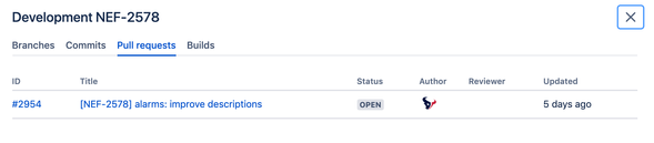

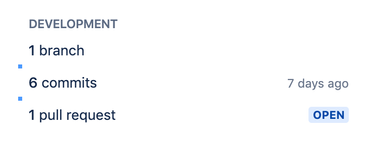

@Belto Actually, that ticket JSWCLOUD-17240 doesn't capture the issue with GitHub. At least in our instance, we do have commits, and there is even a branch.. which has been merged.. and then deleted.
Screen Shot 2019-10-08 at 1.01.29 AM.pngScreen Shot 2019-10-08 at 1.02.51 AM.pngScreen Shot 2019-10-08 at 1.03.11 AM.png
