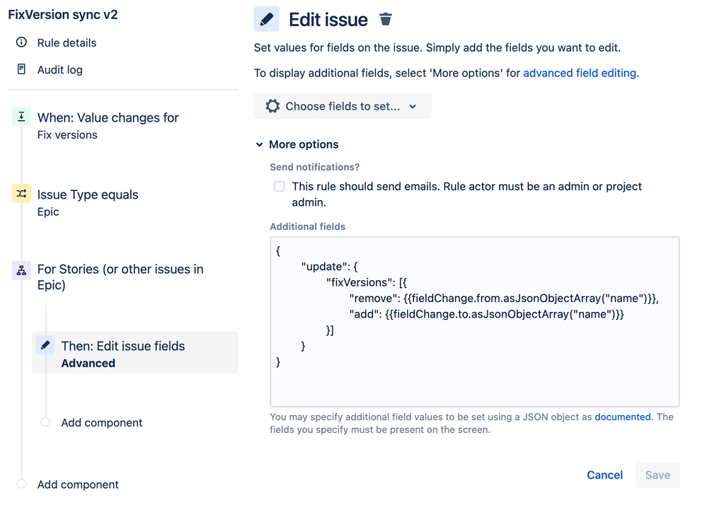

Following the documentation I found here and here, here's my last attempt:
1. When the fixVersion changes => This should give me access to {{fieldChange}}
The changed field value will be available anywhere smart values are supported using the {{fieldChange}} substitution. Use {{fieldChange.fromString}} and {{fieldChange.toString}} to access display values and {{fieldChange.from}} and {{fieldChange.to}} to access raw values (for a select field for example). {{fieldChange}} will only contain the first changed value. If multiple values are changed (e.g. when setting multiple Fix Versions) then you can iterate over these using the {{#changelog.fixVersion}}{{toString}}{{/changelog.fixVersion}} expression.
2. Using advanced fields it should be possible to create a json in which you can specify which fixVersions need to be added to the multiple value list and which should be removed. I tried different notations, but each time I get the error "invalid json" when the automation rule is triggered.
Does anyone know how I can remove the old values of the fieldChange and add the new values of the fieldChange for this multi-valued field fixVersions?

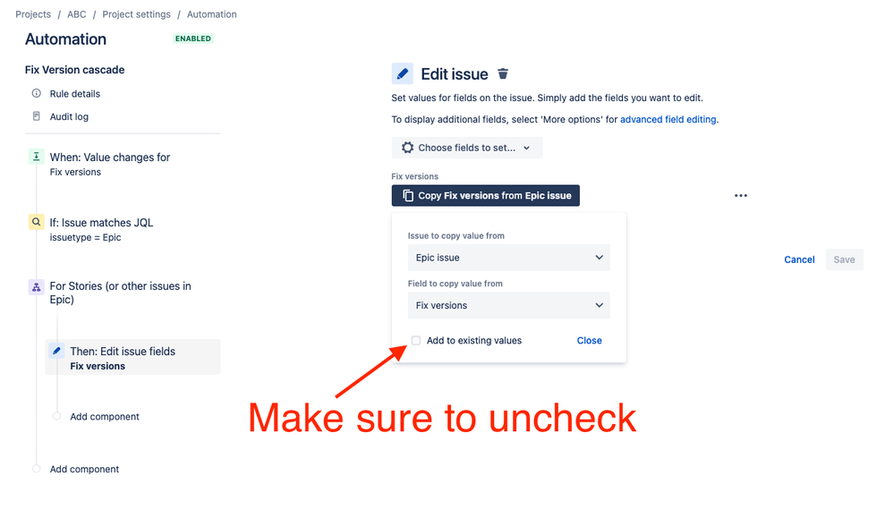

Replacing the fix version can be simplified a lot and acomplished without an advanced rule by selecting the "Copy From" variable and setting it to "Epic Issue" and then deselecting the "Add to Existing values" option like this:
When the Add to existing values is selected the version will be appended to the fields existing values but when unchecked it will replace the value in the field with the new value and remove the pre-existing values.

Hi @Kris Vandebroek ,
The existing value should be overwritten and replaced with whatever value is on the epic when the option "Add to existing values" is not selected.
And testing this out in a staging instance I am getting the result of the value being overwritten as opposed to appending so that the fix version is matching the value on the Epic issue without the original value remaining.
 I made a quick video here showing the result.
Can you verify that the check box is deselected?
Regards,
Earl
