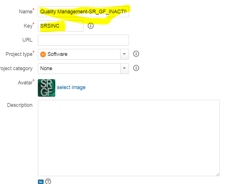

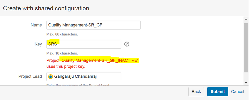

Hello Team,
We have changed the project key (SRS to SRSINC) of a project and when creating a new project with the key SRS, it is showing that the key "SRS" is still being used by another project, even though we have changed it. (see attachment).
Kindly suggest
Regards

This is a limitation of the ability to change project keys.
If you have issues in a project, then change the key, those old issues will still retain information about the old key, so it can forward users to the newer key.
A side effect of this is that you cannot reuse a key in Jira if you have existing issues that have historically used that key. The only ways to get around this would be to delete all issues that have ever used that key, or to hack around in the database, which I highly suggest you do not do.
