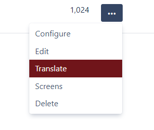

I was able to fix it by doing following:
1) Unlock the field
2) Custom fields -> Action (...) > Translate
and clear the translation
This way is working for me (v.9.6.0). Thank you
