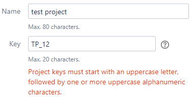

We are currently experimenting with Project Keys and want to add underscores in them.
We found that this is possible and should be working. However when we add a underscore to a new project, we get the following error:
Project keys must start with an uppercase letter, followed by one or more uppercase alphanumeric characters.
Is there a way to get rid of this and get the underscore to work?

The pattern is regulated by a regular expression in Admin -> General -> Advanced.
But don't change it - there are some "interesting" things (i.e. stuff breaks) that happen when a project key is not the standard. Stick with A-Z as the first character and then A-Z,0-9 for the next 1 to 9.

Navigate to: Settings -> System and select Advanced Settings.
In the advanced settings menu you have to search for: jira.projectkey.pattern
I have changed the values to: ([A-Z][A-Z_0-9]+) . This allowed us to start a project with 1 or more letters. Then another letter or _ or number.
